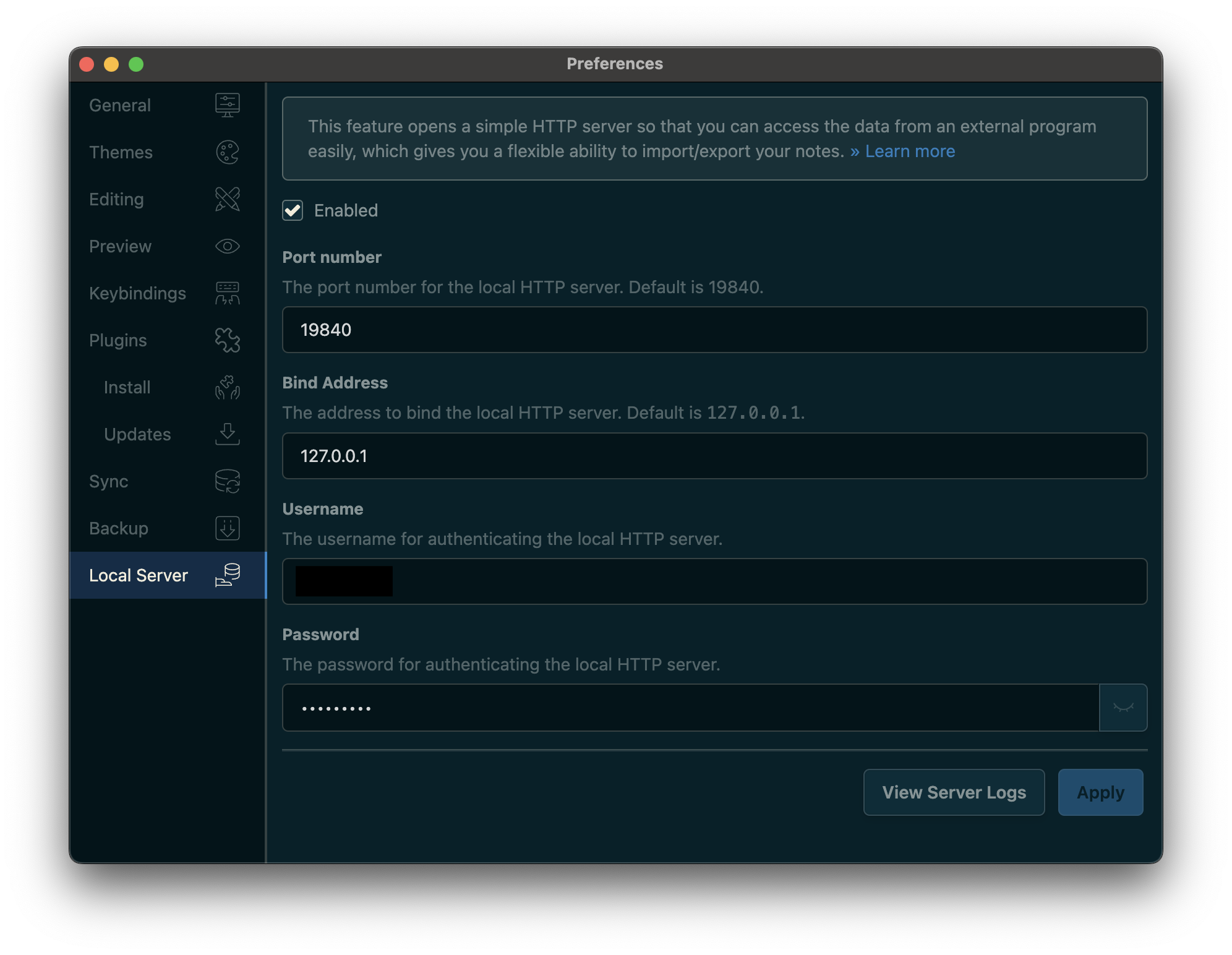

Preferences
Open the Preferences window and click the Local Server section in the sidebar.
  • Enabled - Check this box to enable the local HTTP server. Default is unchecked.
  • Port number - Defines the port number to listen. Default is 19840.
  • Bind Address - Defines the IP address to listen. Default is 127.0.0.1.
  • Username - Defines username of the Basic auth credentials.
  • Password - Defines password of the Basic auth credentials.
Click the Apply button to apply the changes. The auth info will be encrypted and stored safely in config.json in the user data directory.

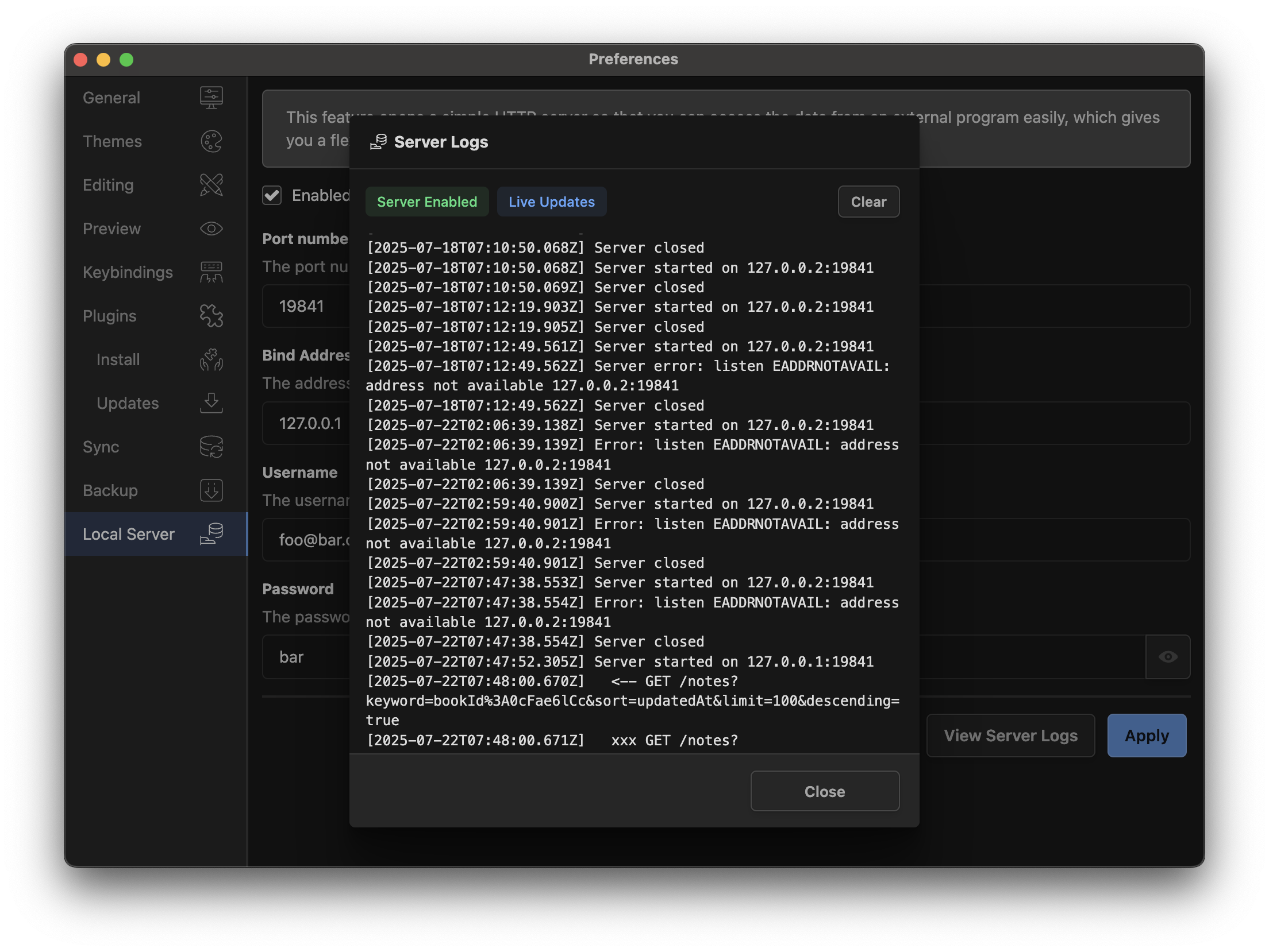

Server logs
By pressing the View Server Logs button, you can check the server access logs updated in real-time. The path to the log file is USER_DATA_DIRECTORY/server.log.
